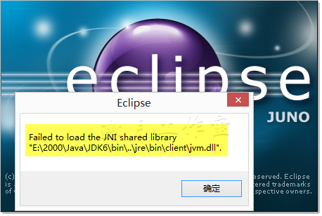

由于开发环境改变,改用64位Juno 64位 SP1环境替换了原来的Juno 32位。结果启动Eclipse报错:
"Failed to load the JNI shared library “E:\2000\Java\JDK6\bin\..jre\bin\client\jvm.dll”

E:\2000\Java\eclipse\eclipse.exe -clean -nl en_US 重新启动Eclipse ,结果报错:JVM Terminated. Exit code=-1
