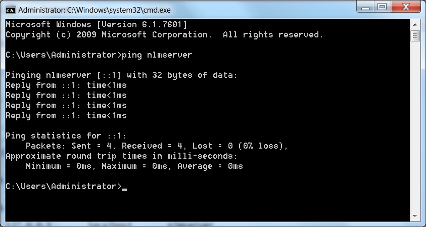

A typical IPv6 response for localhost loopback when the NLM is on the same machine may be one of the following:
  • ::1
  • a full IPv6 address such as 3ffe:1900:4545:3:200:f8ff:fe21:67cf
Your results may look different.

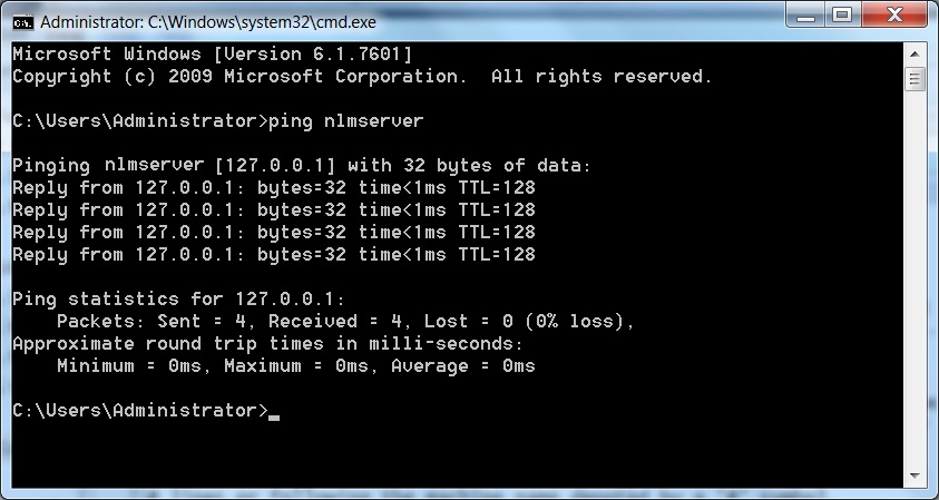

If the response is an IPv6 as in the example above, you need to disable IPv6 on your Network LAN settings and verify PING again to ensure it has an IPv4 address in the format of xxx.xxx.xxx.xxx.
For more configuration changes, continue on to Method #2.

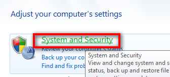

—First ensure that the User Account Control (UAC) in Windows is disabled.  Open the Control Panel and choose System and Security:

  2. Verify IPv4 connectivity by opening the Command prompt and PING the server hostname.  It should now read the appropriate IPv4 response.  If your NLM is local, it should read 127.0.0.1.  If the NLM is on a server, it should read the IP address of your server.
